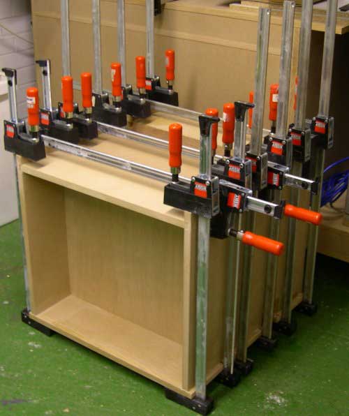

      I've made a load of drawers out of 3/4" MDF with 1/2" ply bottoms. All drawers on my Mobile Cabinet were made with dadoed joints for the back into the sides and a double row of biscuits to hold the fronts on. They've been in heavy service for years now without a problem. Here they are in the assembly stage, fronts downward:

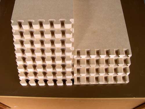

      The main structural consideration is not having them pull apart, so there is another way, if you've got the time and inclination:

      These parts, made with Leigh's IsolocTM "Key" template, became the four drawers for a 600mm (2feet) wide drawer unit in a busy kitchen, fitted with full extension 100lb. stainless self-closing runners - holding up great. Half-blind dovetails would have been as effective, I'd guess, but I wanted to try the "Key" and will use it again - all that glue surface!
      I'm a fan of MDF, but I'll always go for ply bottoms. Well glued and squarely clamped, they're very good. I tend to make drawer boxes, then apply false fronts with the pulls screwed right through so that they operate on the box and not just on the fronts. HTH

        Ray, thanks for the photos! i like the key template cuts, they look really neat.
