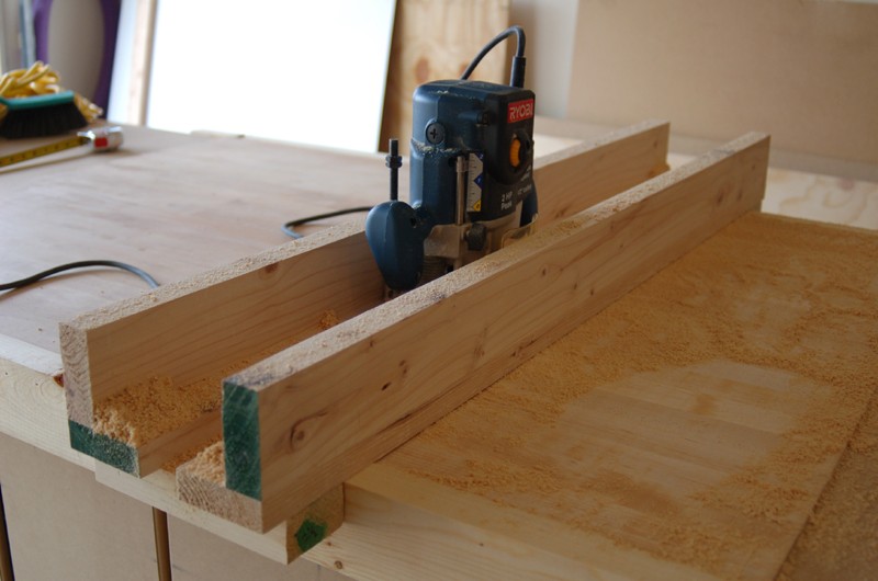

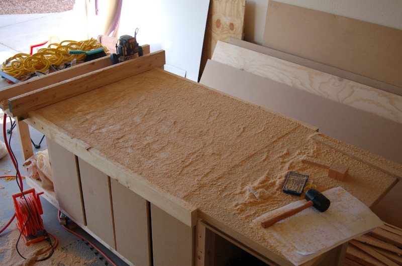

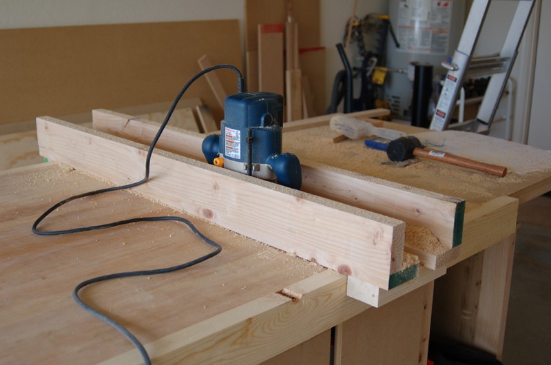

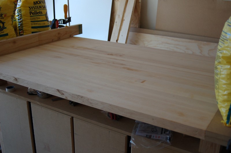

                    here is what i ended up doing.
                    i flattened and edged some 5 ft long 2x4s and attached them so that i was about 1/4 higer than the lowest spot. then i made a sled using again some 2x4s that i flattened and edged as vertical members with a 1"x4" bottom horizontally attached to the bottom of the two vertical 2x4s. Then at the ends, i attached 8" long 2x4s that that held the two members of the sled. they were placed such that when the sled was placed on the side rails, it was snug but still slid without any resistance.
                    when i used the router, i let the bit bite into the side rails by about 1/4" to ensure the the edge would be cut cleanly. i had to do three passes. i only had 3/4" wide bit. it took some time but was fast, i cut going one way and then moved the sled down by 1/2" and cut coming back then moved it 1/2" again and kept on going. when i was done, it has some ridges (little lines) left behind. i used a 100 grit paper and then a 220 grid on my 5" orbital sander.
                    since this was the first time, i must say, it seemed difficult, but was easy. the top turned out to be really nice. the only problem was that i should have raised the rails much higher than 1/4" from the lowest point. the shavings used to get under the sled and raise it, which is why had to go back and do the process three times. didnt take much time at all the 2nd and 3rd time, but it was time none the less.
