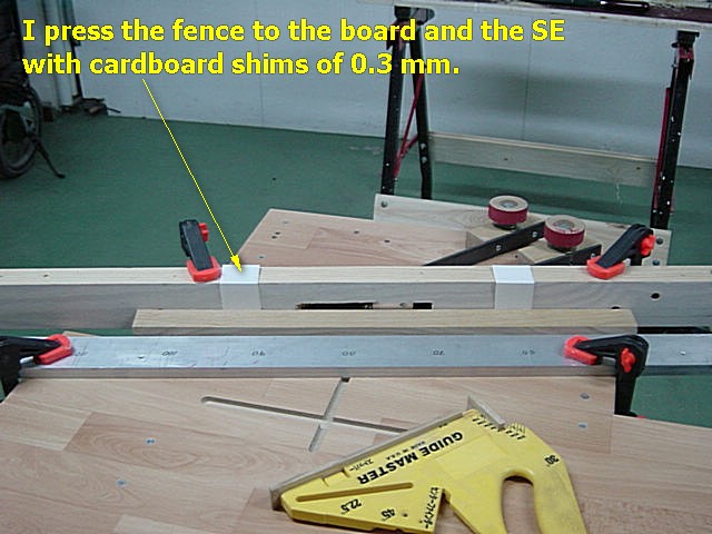

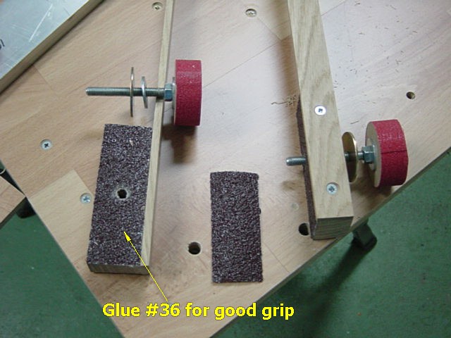

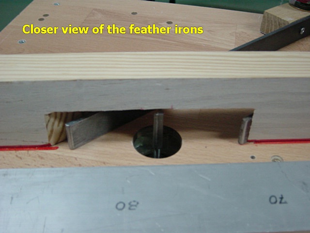

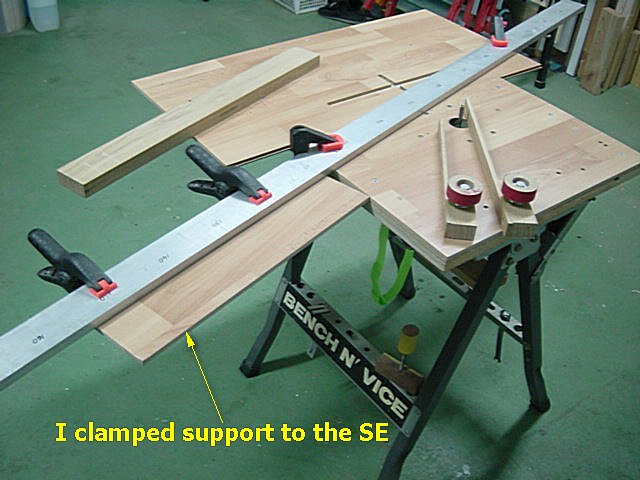

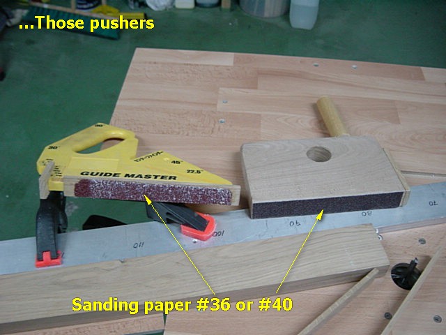

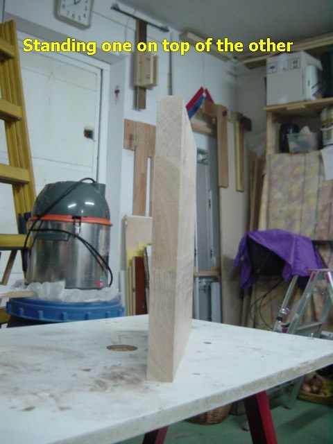

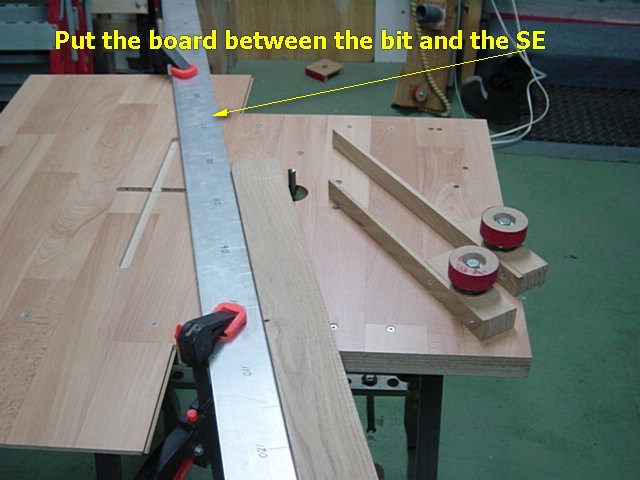

    In one of my replies to "jointing boards for panel glue-up", I've shown some method of jointing on router table but because, with this method the board was trapped between the Straight edge and the bit, many of you considered it unsafe and I removed the pictures.
    But, I did not give up on the method and looked for a safer way to do it because this method not only gives me nice glue-line but also, very consistent width along the board and I use it also for cabinet parts and especially for 45° frame members that consistent width is important.
    The set-up went through few versions and I'm posting all the pics from the beginning (because I don't have others) but please refer only to the last part of the pics, those with the "fence".

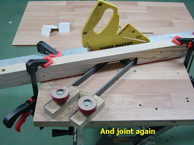

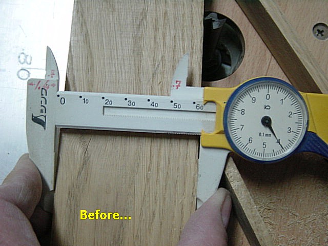

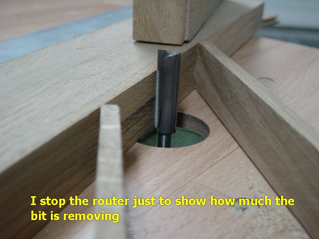

    as you will notice, I'm "shaving" only 0.1 mm (0.004") at every pass and the distance between the board and the "Fence" is 0.3 mm (0.012") which means that in case that "something goes wrong", the board can move laterally only 0.012".

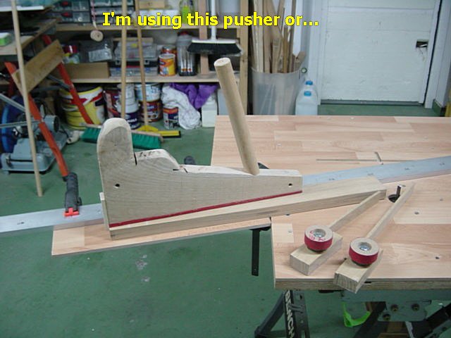

    For the pushback phenomena, I have two safety devices, first, I'm using strong grip push-blocks and second I always stand behind the Straight edge or behind the "Fence".
    Regards
    niki

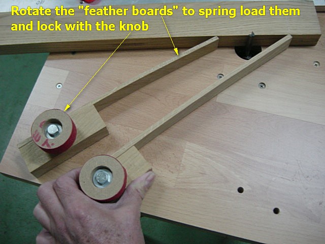

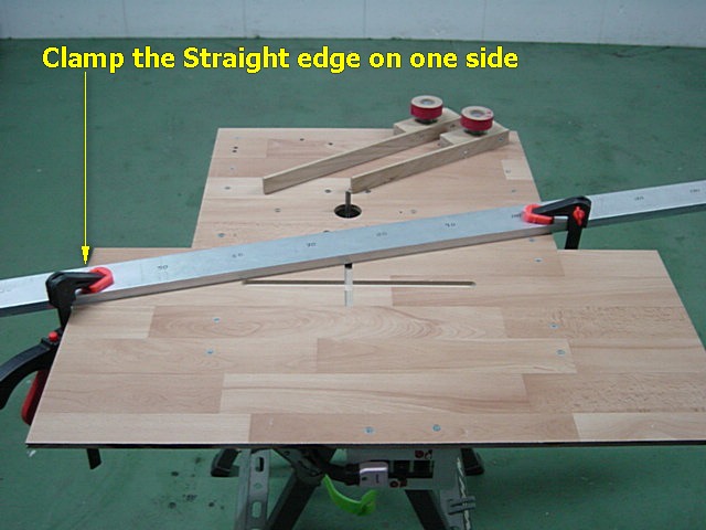

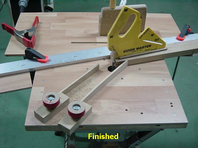

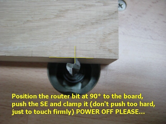

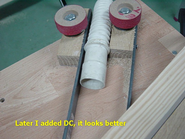

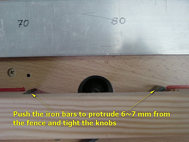

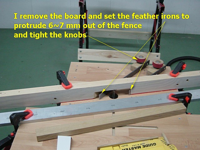

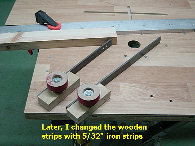

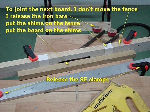

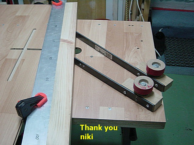

    That was the old set-up
    I added fence that gives me first, safety - the board cannot move so much between the fences and the bit is covered by the fence, and second - only on time adjustment of the bit position.
    To joint the other side of the board (or the next board), I just have to re-locate the straight edge

              I made the fence mainly for safety but then, suddenly I realized that I can use it as a locator to position the next board and clamp the straight edge, without going again through the procedure of "set the blade at 90° to the board" so, I killed two birds, safety and speed.
