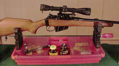

    hey folks-
    anyone here ever made a rest for a rifle? something that is suited to hold a rifle during cleaning and/or sighting in?
    i saw a wooden one at a local sporting goods store and thought "hey- i could make that!"
    this isnt exactly what it looked like, but i will give you an idea of the application
    thanks,
    -adam
