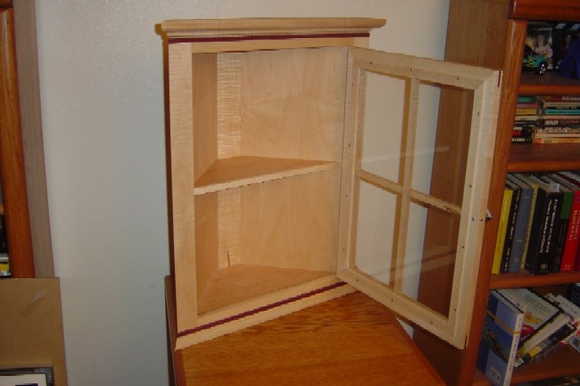

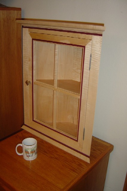

    This is not really too helpful, but I'd use maple "as-is" -- for its beauty in a light, natural color. Here are several pictures of a maple corner china cabinet I just made for my daughter. (The accent trim is purpleheart.)
    We have alder 6 panel doors in our house, but the trim is pine. I've replaced the trim with alder in one room, and will evetually redo it all. The alder takes stain beautifully.
    FYI -- I did a trial finish on the maple, and I liked plain shellac (blond). I also tried Watco Oil, but it was more yellow than I cared for.
    Good luck! And if you really want to stain the maple, I'd recommend getting a book on finishes -- there are several good ones out there.
