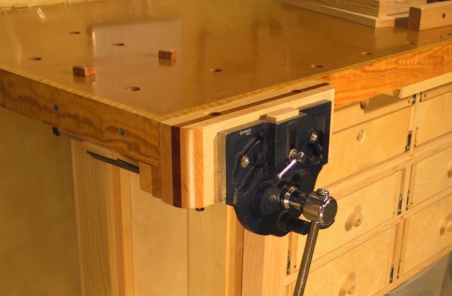

                      Ditto the poly -- several coats, and then I keep it waxed so glue drips, etc. pop right off. If I'm going to be doing any major chiseling, where the chisel will tend to come in contact with the bench top, I put down a small piece of hardboard. There are several quick and easy ways to keep a piece of hardboard in place, if desired. Otherwise, MDF holds up very well.
Name:	Vise and Dogs.jpg

                        3 coats of Hi-gloss poly - applied with a small roller
                        Downunder ... 1" = 25.4mm

                          Rod, is your bench's top two layers of 3/4" (18mm) MDF? What wood is that for the legs and aprons? TIA.
