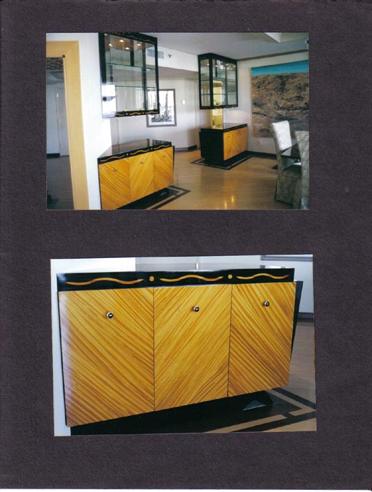

    I don't know if this will be much help, but these cabinets were done with satinwood as the light and ebony as the dark.
