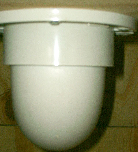

            John, is there any way you can send me a picture of your setup? I would thoroughly appreciate it. That way it takes all the guess work out. This is my first project.
            Dwayne
              Sure here is a shot from under the dust compartment. It shows the flange with a 90 glued into it. A piece of 4" S&D comes out of the 90 and through the back of the router table.

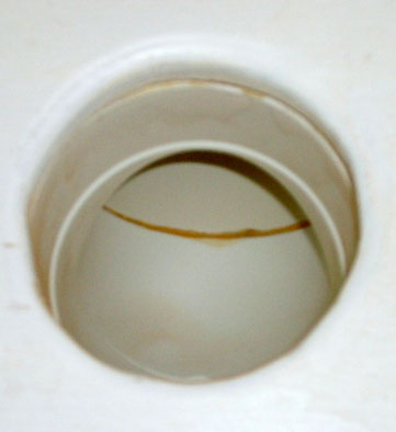

              And this is from inside the dust collection compartment looking down.

                I see. Thanks, John. I was under the impression that it was some special DC piece. That's doable. I see that you painted the I/S of your compartment. Was there any particular reason? Also, forgive my ignorance but what's 4" "S&D"?
                Dwayne
                • Stormbringer
                  • 1387
                  • Floral Park, NY
                  • Bosch 4000
                  I'm guessing that's the flange you see and not a painted cabinet bottom.
                  S&D = Sewer and Drain
                  Good luck with your project,
                  Greg
