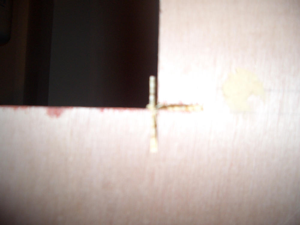

    Picture # 1 is the cabinet top. It's supposed to be 4ft x 18in. As you can see, I cut it about 1/8 in too long. If I slide the rails of the TS all the way to the left for support, I think I can fix this with the SMT to the left of the blade. I think the kerf is about that thick with the factory blade I'm still using, so it would be a pretty fine cut. The cabinet top isn't attached yet, I took the pic with it resting on top after I tried to square it before gluing, and realized my mistake. Is this how you would cut off the 1/8 in?
    The other problem is going to be harder to fix. Pic # 2 shows a side view of the cabinet. It looks like I cut the shelf a little too wide (deep), but what I actually screwed up was the cut of the "L" shape, which is cut away from the cabinet sides, where the doors will be attached. (Again, should make more sense when looking at pic # 3).
    Pic # 3 is the bottom of the "L" cut out. Again, the shelf appears to be too wide (deep), but actually I overcut the L shape depth by about 1/8 in. You can also see that I went too far with the TS when cutting the L (ugly cut marks going past the bottom right corner). These were made on the side of the piece that was facing the table, of course, and I know now to stop a little sooner, and will need to saw a little more with the coping saw next time.
    I guess I'll fill those with putty and drive on.

    For the second problem, you should be able to cut down the shelf using a router. Set the cabinet with the shelf edge facing up, attach a piece of plywood cut about 2-3 inches wide on either side (brads/pin nails or make a jig you can clamp) of the shelf to provide support for the router base, chuck a 1/2" bit, adjust the depth, and you should be able to trim it with two passes.
    You can probably do something similar with problem 1 if you have an offset base for your router if you're not comfortable using the saw.

        I'd fix the top with a router too. You can either set up a fence on the top and run a straight cut bit to trim 1/8 or (and my preferred solution) put the top on the cabinet, get a flush trim bit for your router and cut the top to the exact length you need using the side of the cabinet as a guide.
          Trim the top with a router and a flush trim bit. Clamp a piece of stock on the right cut line for the bearing to ride on.
          On the ends, I would add a 'face' to build up the part that is over cut. Since these are garage cabinets, I am assuming they will be painted so the type of wood used won't matter. Use a caul to get even clamp pressure.
          If you decide to trim the shelf and recut the doors, do as much as you can with the router and flush trim bit. Then finish off the ends of the shelf with a flush trim saw, rasp, file and sanding block (sounds like a lot more work to me).
