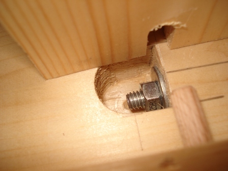

      I used bolts to connect the side rails to the headboard and the footboard. I just used 6" lag bolts from HD. Instead of using dowels to prevent the rails from rotating, I tenoned the ends of the rails, about 1/4". I figured aligning the dowels would have been more difficult.
      Here's a pic of the inside face of one side rail. The dowel you see here is for one of the 15 slats that support the mattress. You can see part of the slat which I had to lift to shoot this pic (BTW, I deserve some credit for being able to do this without waking up the kid ).
