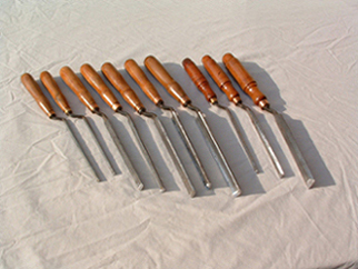

                              For those special tasks grinding a screwdriver will work, as you can make it any size you need. I also use hand carving tools that may be applicable. I also have crank neck paring chisels that I have posted before that come in many sizes and shapes, see below.
