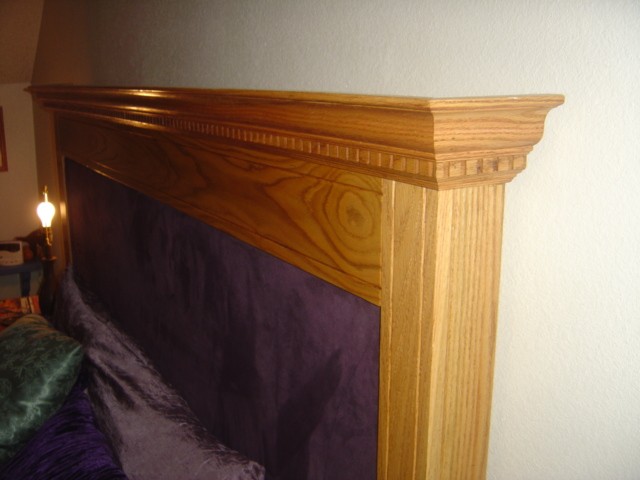

            Unless it was small crown molding, I'd not want to try to make my own on a router table. Maybe I'd invest in a combo molder/planer, if I were going to make a lot. I made a king sized oak headboard, and used large (4") oak crown molding. It cost about $8 a foot. Not fun to make the first cut in a $64 piece of crown, either! (I'd never worked with crown molding when I made the headboard.)
            I can highly recommend the Rockler crown molding jig for miter saws. I had an entry level Delta MS at the time, but with the jig the cuts came out dead on.
