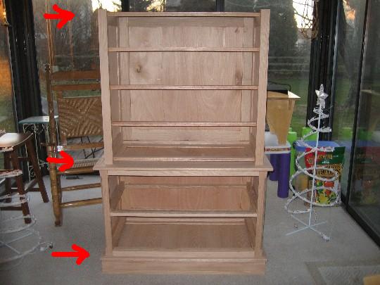

    I am currently building a 7 drawer chest-on-chest dresser. The plans call for 5/8" cove molding in a few places. On the attached picture I've marked with red arrows where the molding should more or less be. I have a length of molding from the local BORG which is 3/4". I held the 3/4" molding up to the dresser and I now see that really the 5/8" would be nicer and not so overpowering. But, nobody carries 5/8" molding. I did use my router and made a short section but it was rather tedious. Could I use my jointer to reduce the size of the 3/4" or is that just too risky an operation?

    Ryan,
    That looks great.
    As tedious as you felt it was to make the 5/8" moulding, I'll bet (what, I don't know ) that's what you'll end up doing anyway.
    Personally, I think it would be safer and quicker in the long run to make it by using your router rather than trying to use a jointer to trim it down. Another advantage is that you have the opportunity (I hope) to use the same stock for the moulding that you used in the rest of the project. You'll get a better color match that way.
    I'm looking forward to seeing the finished project!
    Brian
      Ryan not having a jointer myself I can only guess on how safe this would be. My guess is that there are probabaly better ways. A thickness planer woud be better. You could rip on the tablesaw although that could also have its risks. I would use a router table to route the molding on a wide board then rip off the molding. This is assuming that you are talking about an applied molding.
