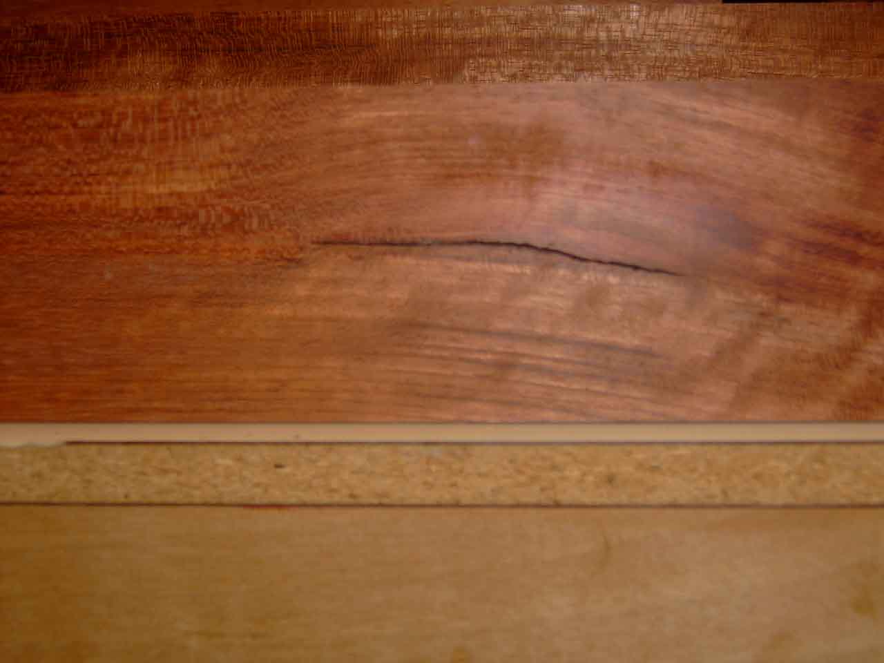

    This crack goes through the board. This is the better of the two sides. I used cut list to make sure I wasted as little wood as possible. I still cut everything a little oversize just to make sure I didnt cut anything to small. After I got it all planed I made my final cuts. Anyhow where this thing was on the board I couldnt really get around it without wasting a decent amount of wood. I decided to put it on display. Its going to be a stile on the side of the desk.

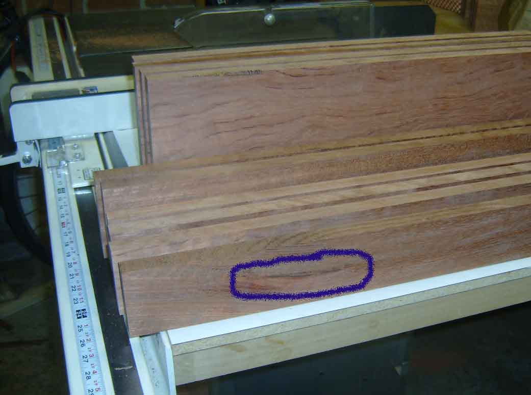

    Those are all the stiles and panels for the outboard sides. I will be using 4 inch rails on top and bottom. I dont know why these pics are turning out so crappy. Guess I need to set my white balance instead of leaving it on auto??? What you see in the pic is almost $100 worth of wood...Thats why I didnt want to make any mistakes....Im not as paranoid when I use a little cheaper wood. One of the boards was QS too. I probably should have tried to cut my panels out of that one.
    I still have alot of the 5/4 QS board left and I am going to put resaw it for flat panels on the insides and make drawer fronts also.

    Does anyone think this crack will turn into a problem down the road?
    I put super glue in it in the back. Should I have cleaned it out or anything?
    I just squirted a bead along the whole crack.

    I've sealed similar cracks with thick SuperGlue.

      I used epoxy in a similar situation to repair a defect and turn it into a highlight. Worked fine.

        Put a bowtie inlay in it. That will help prevent the crack from expanding.

          Did you do both sides or clean anything out? I just squirted it in on the back side so far.
          I have superglue here but no epoxy. Dont have a bowtie jig/form either.

            I had a large crack in a piece of red cedar that was thru-and-thru. I used a thick formulation of SuperGlue on both sides, in several small applications, to almost "fill" the crack. Then finished it off with Bix Stain Putty. You'd have to look very close to see where it was cracked.
              Your poor picture quality (friendly jab) has the wood type hard to identify. Is it Walnut, mahongany, or oak? I would go buy some epoxy (5 minute cure would be fine) if i was you. It will be a great filler and its adhisive strength is without equal IMHO. IMHO super glue works best when you have contact not a gap, just opinion and no expierence using it so perhaps Mildoc is right that it will work. It has for him so it is worth considering. That said for the visible face, epoxy will fill the defect and will appear to be part of the wood.
              They say the difference between a master and an aprentice is their respective abilities to fix mistakes. In my checkering when I make a mistake, cut a line where it should not be or tear out a whole diamond I use epoxy to fill and recut. The finished checkering pattern is so uniform in texture and color that you will never notice where the epoxy is even with 2x aided vision. Epoxy in my expierence acts chamelion in that it takes on the color of the surrounding wood fibers. I've only used it on dark woods though, which it appears you have. For less than $5 you really can't go wrong. Besides Norm the Yank uses black epoxy to fill defects in mesquite to good effect.

                Its bubinga. I noticed at certain angles the flash seems to make the streaks in it white/grey...Im on a small break while my router cools off. I got the first pass done on 4 panels and it started to smell a little like burnt wires. No smoke and HOT to the touch. So im watchin Garfield with my three yr old. He wanted to watch dinasours for the umpteenth time this weekend. I'll have pics of the dry fit panels tonight in a new post.

                  Definitely agree epoxy is best for wide cracks, but the thick formulation of SuperGlue works well in wide cracks also if mixed with sawdust and layerd in. The crack in my board was about 1/8" wide by 4" long and through the board, and I just used the glue alone, sprayed with activator for a fast set.
