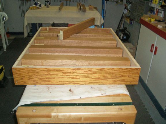

    on my desk i started last night I spent some time working on the top this morning. Doing a little scraping to get the joints flush after I glued it to the plywood base. Mainly because I didnt have much time this morning.
    This evening I got back on track and got the two outside pieces all cut jointed and planed. Still have work to do on the top though.

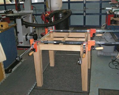

                      Regarding the making issue, I just got done doing it last night (correction: this morning as pointed out by Nike.. ha.. ha..). The joints have been cut.. mocked up with clamps and already sized and ready to go when finish rolls around.
                      Masking doesn't take that long once you get the feel of it and I find that any glue run-over is easier to clean with the finish already applied before assembly. If it's poly, you just wipe it off and no sanding required. And I have assured that the joint was tight and well fitted before I finished.
                      Here's last nights (early morining :>) ) results of masking. I threw my 4 table legs in a rotisserie jig I built in about 30 minutes from scrap to rotate the legs when wipe finish is applied. I can catch all four sides at once using the jig. The stretchers can be put between two supports resting on the tenons. The top side was left "proud" about 3/16" to be taken donw with a hand-plane after glue up. That top side will get a coat of poly then even though covered by the bottom of table too itself. I also entered a pci of the mock up and trial fit of joints before I got to this point.
