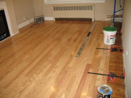

                          Originally posted by cwsmith
                          Jan,
                          Thanks for the advice on the Lowe's floor. The LOML doesn't care for the "plank" width (at least as represented by the Dupont flooring at Home Depot), preferring instead the narrower width. We actually had it all picked out last September (Pergo) and the guy at Lowes said to wait a month because the price was going to go down substantially.
                          Got this from Lowes two years ago when they first came out with the individual 3" width laminated planks with real wood cores. I still haven't seen the individual planks at Home Depot.... just the 10-12 inch wide ones that are "three" planks wide that all end at the same point. My brother put that down in his living room and is regretting it. He got suckered in by the displays that they have that only have them connected side to side where they look really good. Onece you connect them end on end it's a different story. YMMV of course.
                          I particularrly dont care for that look having all three rows at the same spot at various points throughtout the floor so we went with this when it first came out. Pergo hardwood, $4.60 ft. About 3/6" thick so it really didn't affect the transition from room to room.
                          I could not get the old floor light enough for the LOML. She liked the light natural look. I tried to convince her to let me rent a floor sander and try bleaching it but the new stuff just looked to good. I like it so much I want to put it down throughout the first floor but she has her heart set on tile for the kitchen.
                          Greg
