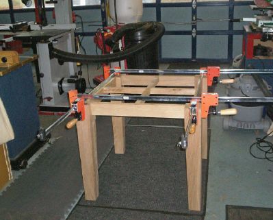

                    And you are correct about the old craftsman. In the current thinking mode of having to have the latest, greatest.. I sometimes have to scratch my head and chuckle. I had an uncle that was an excellent carpenter and furniture builder when I was growing up in rural metro-politan county just outside Atlanta.
                    He and his cronies built houses with the use of hand saws, brace and bits, hand planes, etc... Those houses still stand as a rock and so does the house his father built well over 100 years ago now. And you won't see a crooked wall inside as seems to be the norm with new construction now. :>)
                    To answer your question as to how much larger the panels should be built bigger than the frame on each side:
                    To me it would be determined by how wide the face frames are. All I ever wanted to be as a kid was a "timber-framer". That line of work was almost obselete by the time I did my military duty and returned from VN in 1969. So... I'm not a timber-framer, but.....
                    With a natural instinct from a timber-framers frame of mind, I tend to hedge to bigger than I know will be sufficeint. If 1/4" is enough, I would probably go 3/8".. etc. etc. I have built a lot of work-benchs for freinds over the years to satisfy the urge for timber-framing. I design and build them to with-stand tornado, earth-quake force. "Like a rock" as they say.
                    I just mocked up a country kithchen table base nite fore last. The tenons on the stretchers to legs are 2 1/2' tall.. 3/4" wide and 2 3/8" deep with 1/4 inch shoulders. The tops of the legs are 4' x 4" and taper to 3" to the inside. Is it more than I need to avoid collapse from the weight of a meal placed on top or someone leaning or sitting. Yep..... but with all that in mind and the fact that I might just sit a 55 gallon barrel of "grits" on top or re-build an engine in a pinch... I do it my way much unless the "First Lady" rolls her eyes with enough concern for delicacy to back off "full throttle". ha... ha...

                      that's a nice looking table base you have there sarge

                        Thanks silicon...
                        I suggested adding a Veritas twin tail to one end to squeeze fresh orange juice or a lazy susan in the center with a statue of the Marines raising the U.S. flag on Iwo Jima, but got over-ruled as usual by charming wife.
                        Even though our taste seem to differ, I suppose it is for her and she gets to make the call...... this time anyway. ha.. ha...
