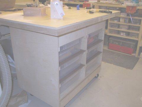

                    I made what is basically a mobile workbench/cabinet for my outfeed table. The top is ~30" x 48", and has a torsion box base. The top itself is 2 layers of mdf followed by 1/2" baltic birch. Still has the "temporary" plastic tub drawers.
Name:	Outfeed Bench2.jpg
                    Since it's mobile, turning it 90* for long rips is not a problem:
Name:	Long Rip Side2.jpg
