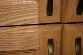

            I don't know if I explained the problem adequately. Here's a photo that may help. See how, in the middle, the 2 diirs are touching, but the top and bottom they're apart, just about a 1/16, maybe 3/32, but still.

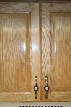

            And the second pic shows the frame that is starting to loosen, the left bottom door.

                First, if all the doors in the pictures are mounted, you could use more space in the middle. The closer you space doors, the more obvious slight imperfections look. It would be a stroke of luck to have absolute perfection. Some of mother nature we have to live with. The gap (separation) looks negligable. You could put a straightedge on each of the doors and see which one is out, and how much. Check to see if the panel is jammed or caught to keep it from moving in the groove. If the panel is loose, see if a clamp will pull the stile in. If it moves freely without moving the panel, it could be just the stile having a slight bow. It could be those spaceballs hanging you up.
                As for the joint that looks like it's coming apart, also check the panel to see if it's free in the groove. See if the joint can be closed up. If the panel is loose, you may just have a glue starved joint. Remove door and force some TBII into the joint, pad it in, clamp joint closed, and damp wipe wet squeezed glue off.

                  I agree with Cabinetman 100%. Your doors are likely a shade to close together and are magnifying that slight imperfection. I believe that issue is related to rail and stile movement (the wood) versus panel movement.
                  I believe the rail/stile seperation could be due to the spaceballs. After milling my raised panels using a raised panel bit in the router, I will trim approx 1/16" off each side of the panel. Otherwise it takes more clamping pressure than I like to get the rails and stiles to interlock. While I really like the space balls they do take up a bit of room inside the groove.

                    Thanks again for the suggestions. The doors are mounted, but with clip-on hinges, so easy to take off and adjust.
                    You say it looks negligable, and LOML has not said anything yet, maybe I'm just too finicky, but I'm going to try and pull the stiles in with clamps, like you suggest.
