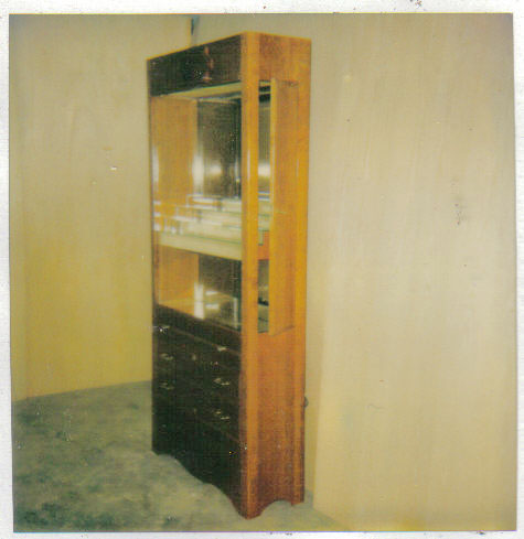

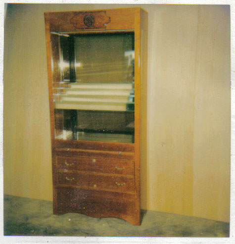

    I don't stain cherry. This cherry cabinet was made to house and display hand carved ivory. It was done with a water white clear lacquer. I've also used varnish. Sorry about the quality of the pictures but they are older Polaroids.
