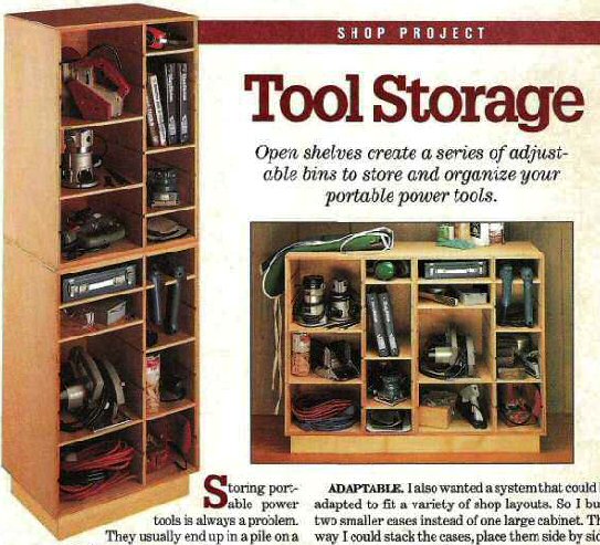

    I like the design of the power tool storage solutions in the new issue of Woodsmith, but it calls for using plywood. i have a lot of MDF (bought too much for another project) in 3/4 and 1/2 thickness. I was wondering if this would do for the cases and the dadoed shelves in their design #1, or would the MDF tend to sag on the removable shelves, or chip / crack in the dadoed case sides?

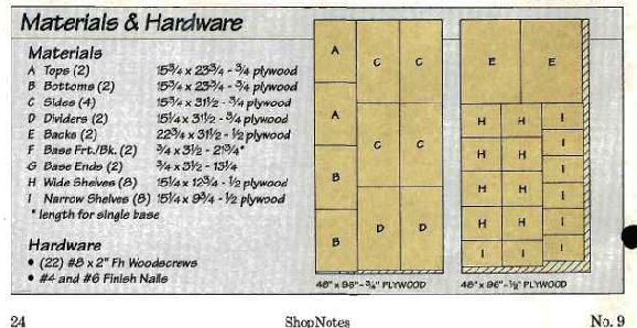

              btw, that plan is just an abbreviated version of a very old plan from Shopnotes #9, where they have lot more detail - measurements, cutting list etc. Its also part of their give-away gift (with their SN subscription) 'The Complete Small Shop'.
              With a max size of 15" x 13" for the shelves, a plain 3/4" MDF should do pretty good, without needing any edging support.
                Thanks! I knew I seen a similar plan before but could not remember where.... gettin' older ... darn ...
