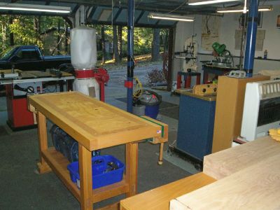

    I recently finished my first workbench. I used birch for the whole thing. I (so far) lack milling tools, so I opted to "cheat" for the top as well, but I ended up with a nice sturdy top that was very easy to put together.
    I bought two Ikea VÄRDE countertops and laminated them together. The countertops are chamfered top and bottom, so I trimmed around the edges and then glued on 3/4" birch all the way around to edge band it.
    The countertops are $80 a piece, so it's perhaps a little more money than you want to spend. But I spent zero time flattening the top. Just a little danish oil and I was done. To me, that was worth it. You can get the countertops right in the self-service furniture section of Ikea.

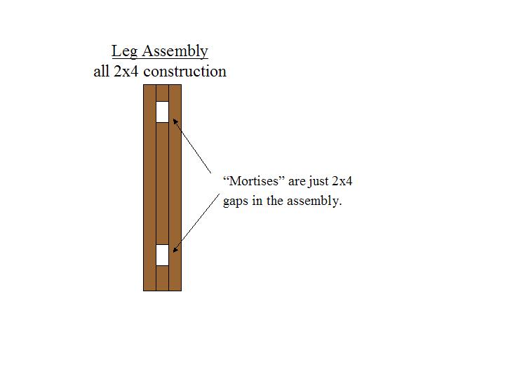

          I'm not sure I'd worry about mitering the corner. If you just used a bunch of inter-locking butt joints, you'd have nice strong corner. It's not going to show, so the quality look of miter joints will be lost.
          For the legs, I've seen some designs that use three 2x4s. The middle one is cut in pieces to allow a stretcher to be put through a "mortise" created by the pieces.
          Just a couple of thoughts.

            Thanks for the advice. I'm not sure I understand your idea about the stretcher through the three 2X4s though.
            Would you mind clarifying for a noob?
            OST- do you mean leaving the middle one short and using the slot to hold the stretcher between the legs at the top?

              ============================= 1
              ====gggg=============gggg===== 2 (in sections)
              ============================= 3
              g=gap
              (lying on their edges)
              Downunder ... 1" = 25.4mm
                Well, here's a crude diagram of the idea. Build the stretchers into the "mortises" as you assemble the whole thing.
