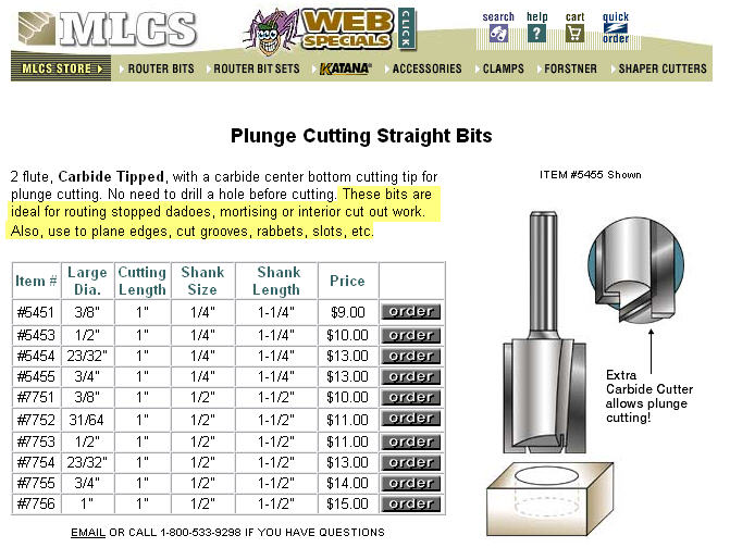

          Originally posted by knimac
          My question is whether to use 1/4" straight cutting bit and drop the rail onto the table,
          knimac,
          I don't think a straight bit would work since only the edges do the cutting (used to enter the workpiece from an edge of the workpiece.) Sounds like you want to "plunge cut".
          Your method seems a little risk-A to me. Why not go from above with a plunge router and just clamp the same height stock to the left and right of your piece so you have more surface area to support your router with a stop at each end? I don't see how "Dropping the piece" onto the bit can ensure accurate repetitive starting points if you can't see the bit enter the workpiece. Or am I misunderstanding you...which is most likely the case these days.
