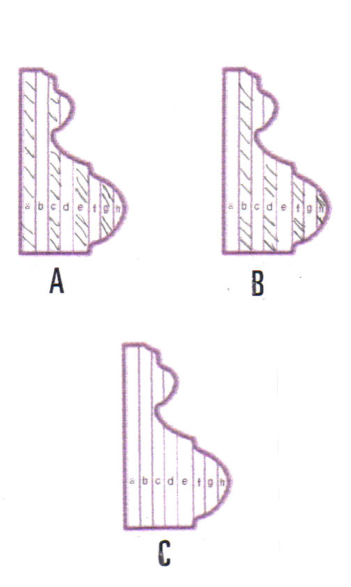

    This is a procedure to make curved moulding, that is of any profile. If what you want is larger or longer than the solid stock you have, or it's too much to make it out of solid stock, this might work for you. I came up with this method many years ago out of necessity, with excellent results. The idea with this is you will be needing two (2) lengths of identical moulding "A" and "B", to make curved piece "C". Keep in mind this is a lamination method and the final moulding will have varied grain due to it being laminated from two different pieces of wood.
    As you see in the drawings, "C" is cut to be glued up and installed along its left side. You can start with buying two identical pieces of moulding or make them. The drawings for this explanation are segmented into 1/8" sections. Most woods will bend well in 1/8" thickness. Each segment of "A" and "B" represent a "save" or "saw kerf".
    The cross hatched segments represent a "saw kerf". So, after slicing on the TS the segments of both "A" and "B", you will save the segments "a" from "B", "b" from "A", "c" from "B", "d" from "A", etc, for the rest of the profile.
    When you have the "saved" segments they will get glued up to form "C" moulding. They can be glued up and clamped all at once or a few at a time. It's imperative to align the moulding up so the profile will be consistant.
    Taller curves can be created by just vertically stacking one or more profiles, provided you have made forms for the moulding to glue to. Segments that are covered by another segment can be pin nailed if necessary.

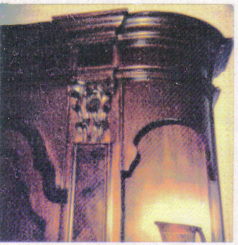

          There are many instances that would make your procedure impossible. For example: Suppose you need a 1" high half round to bend around a 12" radius. Doing what you described would entail making a flat form to glue up your flat pieces to and having enough flat on top and bottom of the form for a bearing to ride on. Then if you got to that point, holding the router 90 deg to the stock would be very difficult. If, you just glue up your unprofiled stock to the radius, there is no way with a router could you produce the half round portions and stop on the radius that it's glued to.
          The other method of your procedure would be to use a shaper, or a router/shaper setup, and holding the moulding to shape the profiles would be another impossibility.
          This method alows for the making of an exact profile to fit any curve or groups of curves and have it match up to any straight sections using the same profile.
          I have to apologize for the picture below as I took it about 20 years ago with a Polaroid, and it was very dark (mahogany). Tried to lighten it up to see some detail, but it's a little fuzzy. I made these cabinets to copy an antique, and the curved portions of the crown had to match perfectly to the straight sections, and they did.
