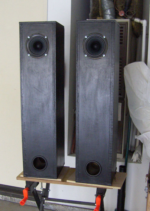

            want some speakers?, here...
            Originally posted by gimpy
            gychang, what speakers are you considering on building? Would love to know.
            I am nearly finished with tall speakers, called Bigger Is Better (BIB), u can read about it here.
            http://www.diyaudio.com/forums/forum...?s=&forumid=51
            I finished my first one below, sounds divine..., proper cabinet (from computer simulated calculation) does wonders for these speakers.
            For both speakers, holes were cut with jig saw, works but not precise. My speakers are less than $20 each, so the plywood cost is more. To me sounds better than the Best Buy stuff at much higher cost...
            gychang
