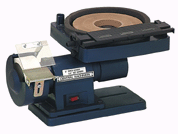

                      I use one of these to flatten the backs, and get a start on the edge. I then finish with scary sharp to about 2000 grit (sometimes 3000). It's a harbor freight tool, so I don't expect a tremendous amount out of it... but it has enough surface area to flatten most chisels (or at least the whole back). And then the finishing touches with the scary sharp method. works for me.
                      Here's the link to the item at harbor freight, and between that and the sandpaper, prolly less than you would spend on good water stones.
                      http://www.harborfreight.com/cpi/cta...emnumber=33867
