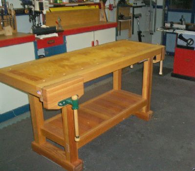

                    A maple or beech top is perfect, but not necessary. A maple or beech base is great, but even less of a criteria than that top that needs to be flat and hard as it takes a pounding. I have made about 20 work benchs over the last 34 years. Some simple.. some complex and some in the middle. The nicest are in the shops of friends that requested and can afford them and not my shop. But they all have something in common. They are all built with wood, designed to be rock solid and the joinery was not short-cutted. They all are were designed for either the personal needs of the purchaser or my own needs.
                    My current bench base is made of re-covered and re-sawn Doug Fir beams from a torn down civil war warehouse here in Atlanta. Before I mounted the partial maple top, we anchored the base to a 600 lb. crate motor and attached a cum-a-long on the other side to see if we could make the joints separate. The crate motor moved, but the joints stood fast and remain steady.
                    The top is partially maple left over from projects, a few strips of oak for the dog hole and a quick replace birch ply insert on this one. It's flat and when seaonal changes make it otherwise, a hand plane takes it back to ground zero or just replace the insert. Life is simple.

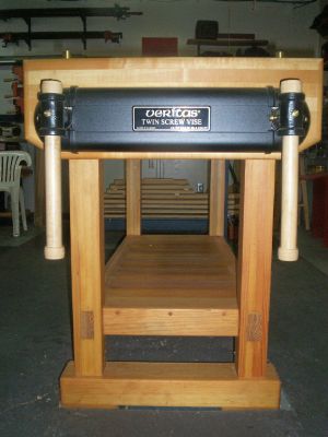

                    My bench cost around $200 and that is the Veritas twin and front vise hardware. Jaws are made from left over shorts. One of maple and front of oak. Open bottom as I like open and over-lapped edges for clamping and toe room on the bottom as I hate to be distracted with a toe jamming into the base of the bench. And for some reason, it fits exactly in the space I had available for it.
                    Not show class.. not expensive... but she'll be around long after I'm gone and the bottom line is she "gets er done" and she doesn't know what the phrase "quitting time" means! ha.. ha...

                      What a beautiful bench! I have been thinking about the necessity of the tool tray, not only because of it's complexity to build, but it would seem to me to be a dust collector and I like the idea of having the entire bench usable for projects. I think I can speak for everyone here - your bench is a showpiece in our book and we would all be proud to have it in our workshop. Well done! BTW, did you build this with plans or is it your own design? If plans, where did you get them?

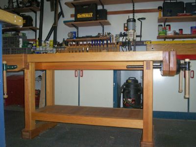

                          Howard, some folks like tool trays.. some don't. I have two wall built cabinets with work-space tops behind the bench and my morticer sits in the center. It serves the same purpose. That way I get more solid space on the bench itself. I do have assembly talbes, but I still like my main bench surface about 24" to 26" wide and solid.I put trays on some earlier benches, but decided one day that for my style, more cons than pros. One man' poison may be another's cup of tea.
                          Plans come from sitting in the shop with a cup of coffee and deciding what I want. The idea comes first.. then the rough drawing.. then figuring the joints and the exact dimentions. A spiral note-book and penceil produces cheapest plans. I have never to this date built anything from someone elses plans. I won't say that I haven't looked at other pieces for ideas, but the final design. dimensions, etc. comes from me.
                          This bench is one of my last 8 that all have what evolded into what I call a "whale-back" base. Take a look under the top of the 1st picture. Do you see a wide rail from end stretcher to end strecher. That's a 4" X 5" laminated Doug Fir "whale-back" that sits inb a lap joint on each top strecher. The side strechers tie the end's together at the bottom. I use a whale-back to tie on top instead of the top itself which can be removed by lifting it off the 4 bullet shaped dowels at at the corners of the base. Gravity holds it down.
                          Without the top, on this current design base... it won't budge even if it were not glued, which it is. The combination of through mortise-tenons, saddle and lap joints along with the design make the base self-locking when assembled. Just for fun.. add a little dab of glue and a pin here and there and "kiss my southern hind-side" Hurricane ...???.... ! ha.. ha... ha..ha..ha..
