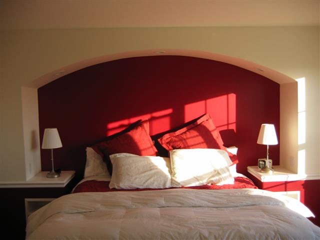

            Yup...been there...done that. Someone explained the problem with red paint to me once. It had something to do with the opacity of the pigment, but I forget the specifics.
            I too vowed never to paint another wall red as long as I live. My MBR project took a coat of grey primer and 6 coats or red before I was happy. FWIW... I used Behr.
              [ATTACH]2563[/ATTACH]
              Nice job on the bedroom, though.
