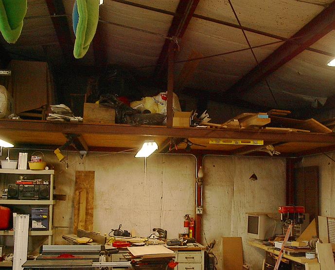

I've decide to put cabinets in the shop, problem is, its a steel framed building, no walls just insulation with a fabric covering. The shop side has a storage loft with a 3/4" plywood floor. I figure I'd run stove stove bolts down through the plywood. I plan on building from MDF, would that not be the best choice? Any ideas on how to hang them?

Could you give more details of exactly how the loft is done and what it's made of, and how it is attached.

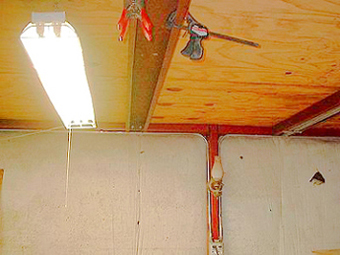

Its supported by steel C channel thats flush with the perlin thats at about 7'. I think I'd hang em just below the C channel, rather than tight to the plywood. Also wondering the best way to construct them, the plans I'm going off of call for just rabbit to connect the top to the sides.
Heres a couple of pics
Edit: the C channel is 3" thickM. Leichtle

I took your picture and lightened it up enough to see what the heck the channel looked like (see below). The edge that you have the clamps attached, don't know what that dimension is (length 90 deg to the plywood). Anyway, you could bolt a 2x4 on edge to the edge of the channel, and then run cross members the depth of the cabinet. What you will wind up with that way is a frame the size of the top of the cabinet, bolted to the channel, then you use long coarse thread screws through the top of the cabinet into the 2x4's.

You could just install the cabinet right to the plywood with long bolts 1/4 x 20 minimum with large fender washers. If the cabinet is longer than the distance between the channels, mount a like spacer on top of the cabinet to equal the channel height. The whole idea is to disperse the weight over a large area.
