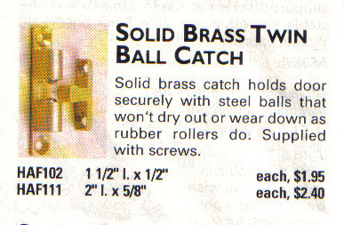

      Here's a couple of suggestions. The first one is a brass ball catch that the parts can be turned to meet a variety of mounting positions. There is adjustment of the pressure on the ball.
      The magnetic catch gets bored into the wood, so hardly anything shows and the magnet is not super super strong. You might want to sample one of them. Hope this is a start.

        Thanks for your replies and insite. Those are the only ones that I am considering. I didn't know if there is some magic catch that I had not seen. I'm probably over-thinking the problem.
