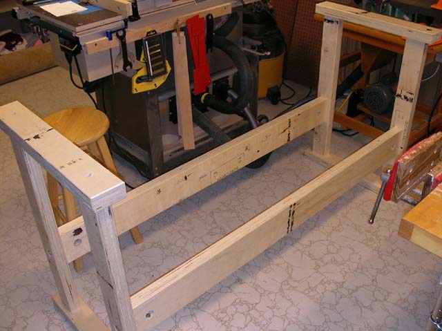

    I spent a few hours this weekend building the bottom to my LVL (Laminated Veneer Lumber) workbench. LVL is commonly used for things like overhead garage door headers. Strong. Not too expensive (this base was approx. $70 with plenty of good-sized leftovers). And incredibly stable. I plan on using a solid-core door for the top.

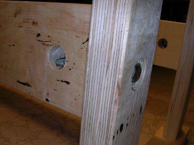

    Each stretcher joint connects with two 1/2" dowels and a 1/2" x 4" long hex-head bolt threaded into a 1/2" wing-nut used as a cross-dowel. Very sturdy. I put all my weight on the middle of the 5-1/2" wide stretcher and it didn't deflect.
    I would like to paint the base. First of all, the surface isn't perfectly smooth. Perhaps I should swipe a layer of auto-body filler on the faces before painting? That should fill any defects. Would auto-body filler work okay for this? I've never used auto-body filler, is there some specific brand/type I should use, that I can pickup locally? I also have Durhams Rock-Hard Water Putty. Would one or the other be more likely to pop-out? I imagine the auto-body filler would stick better. Do I need two-part auto-body filler? Or is there a one-part product that would work?

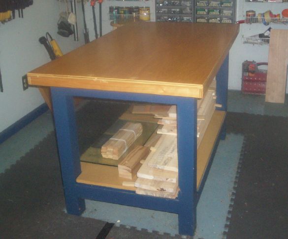

              Thanks Sarge. I purchased Dutch Boy semi-gloss porch and floor enamel (latex) paint today at Menards (I like the plastic jugs Dutch Boy uses). I rolled a coat of primer on earlier and this evening I started the porch paint. Very thick stuff. I'd almost say goopy, but there are no lumps. :-)
              I'm going to roll/brush two to three thin coats on. I know it is just a bench, but I figured I'd do as good a job as I have time.
              All I gotta do is get my door for the top, and I plan on building some cabinets that will sit on the stretchers and provide some additional support to the top from underneath.
