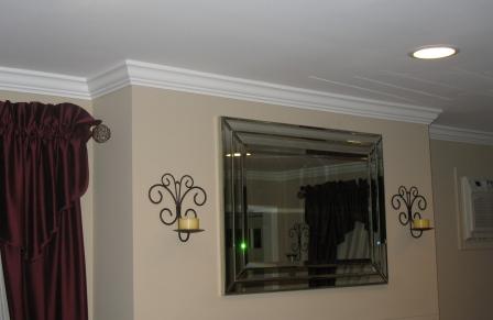

      The scarf in this picture is directly above thecenter of the mirror. I could have easily bought another 7 foot piece but I had enough to make the run with two scraps I had left and besides it was 3 in the morning and the borg was closed. The second picture is a close up and I even have a hard time finding it. If you will be doing additional crown, I strongly suggest MDF. Just my $.02
      With your current situation, short of taking it down, I would just play the sanding and fill game until you get it right. Don't use silicone as that won't sand well.
