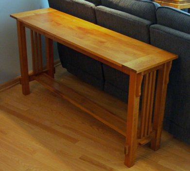

                    Hmmm. . .. . I could have sworn I posted a response to this last night.
                    I made the following table out of alder for my MIL. I liked working with it, but it does dent easily.
                    Brian
