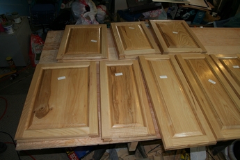

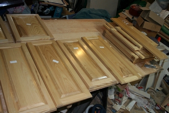

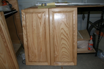

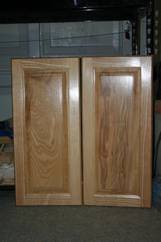

              Thanks Cabinetman, downloaded the software, it worked great, so I'm trying to attach some pics.
              The first pic shows the doors that I was concerned about, the rest shows the rest of the doors.
                Those doors look great. Nice finish. If you made frameless cabinets, you can use the hinge that mounts on the cabinet side, not on a 3/4" FF edge. The cabinet side mount is a much more substantial hinge. On the ones you did, mount your hinges 4" up and down on the door. If you think later you need a middle hinge, you can add it. It takes a little patience and experience to adjust the third middle hinge to be compatible with the top and bottom hinge. You want it to be helping, not working against the adjustments of the other two.
