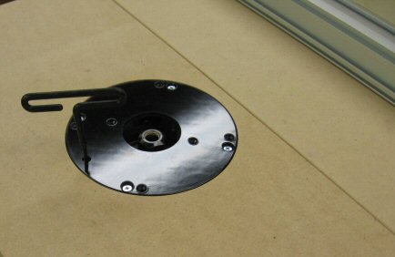

I'm building an extension wing with a router mount for my BT; this photo shows a portion of the wing in prototype form. It uses a Bosch 1617 fixed base mounted without any kind of plate or lift:
The top panel of the prototype's wing is 1/2" MDF; the final version will be 1/2" Baltic birch plywood covered with plastic laminate. (There is a stiffening rib structure underneath to allow the top to be only 1/2" thick, without sagging.) The router's plastic subbase is set into a ~1/4" deep recess in the top. Under the black plastic plate is a ~2-1/2" thru-hole in the middle for bit clearance; this leaves a 1/4" thick lip of MDF that's about 1-3/4" wide all around. The router's fixed base casting simply fits tight against the underside of this lip, and the four machine screws hold the resulting sandwich together. With this setup, I actually lose less bit travel than if the same router was mounted to the BT's accessory table, using the mounting plate from the accessory kit.
Bit changes are handled by ducking under the table and dropping the motor cylinder out of the base. When the motor goes back in, the bit height is set to roughly the right place and then fine-tuned from up top. That's why I asked if you have the newer version of the Bosch base that allows above-table height adjustments ... although the bit height could be set entirely from underneath, the top-side adjuster makes the process easier.
I should mention that I have a separate, standalone unit for my primary router table, complete with a Rockler/JessEm Mast-R-Lift. But I have been using the BT's accessory table as a secondary router station for simple stuff like roundovers, and eventually realized I was using it enough to justify building something larger and nicer. My first impulse was to design the extension wing to use a drop-in plate, but the more I thought about it, the more I asked myself, "Why? What would that gain?" In the end I decided it would gain nothing of significance, and cooked up this approach instead.
Something to consider, maybe?LarryComment
