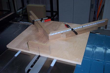

    I used screews and glue, worked real well. The glue allow me to make final adjustments, when it set used screws to insure it did not move

      Ditto - Otter
      First fence setting - using my "special" clamps
      Downunder ... 1" = 25.4mm
