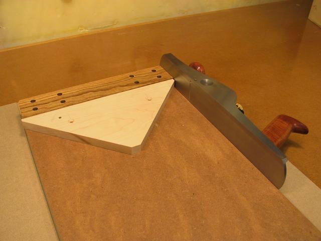

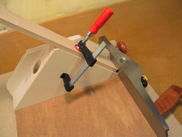

    You can cut your miters however you want, so long as you clean up with something like this:
    Or use one of the fine miter sleds that will soon be posted.

      Thanks. I'm sure will help. I apreciate it.
      What exactly am looking at? {g}
        If I'm not mistaken, that setup is referred to as a "shooting" sled.
        Brian
        Welcome to the school of life
        • RodKirby
          • 3136
          • Mao Shan TSC-10RAS
          Shooting BOARD
          Downunder ... 1" = 25.4mm

            Originally posted by RodKirby
            Shooting BOARD
            Thanks Rod, I knew sled was wrong but when I'm at work I seem have a lot of brain farts.

                    Tom,
                    I had never heard of a shooting board before, but it solved my problem of how to get tight frame miters. I need to buy a larger plane like the one in your photos. I'm searching ebay, mostly for Stanley's. Is there a size/model you would recommend? Thanks.
                      Shooting BOARD
                      ...and silly me always thought they were talking about one of these:

                        Originally posted by boxman
                        Tom,
                        Matt
                        Matt, the plane in the photo is a Veritas Low-Angle Jack. A comparable-size Stanley would be a #5, while a #7 (jointer) would be good, too. Even though a block plane would do, it's good to have something with a bit of weight so the momentum will carry it through the cut.

                          That's my method to make sure the sides are equal length and the stock doesn't move during cutting. If my setup is right and I paid attention at this point I'm done and the box will fit very nicely. However, I also have a shooting board as Tom shows and you can't believe how well that works until you've actually tried it.
