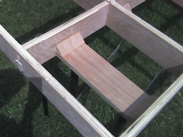

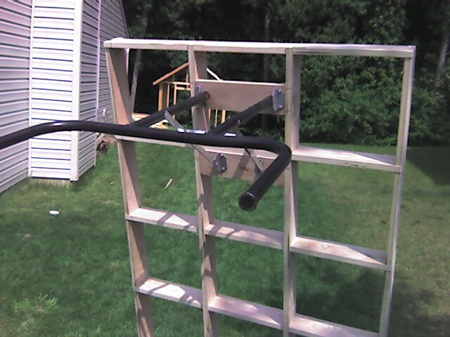

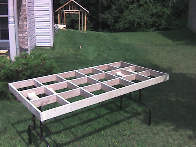

    I ripped 3/4" plywood to 3-1/2". Then I gang cut the dados to make the grid fit together. I used brass woodscrews in case I cut too deep and ran into the screw. The legs were $10-12 at Menards.
    Joe Sacher

      Nice, definetly more work than I have seen put into one of these.

        Makes mine look like crap
        but I used no hardware, everything is slip fit and I knock it all apart and stand the pieces in the corner when it's not in use. When it gets tore up, takes about a half hour to make a new one. Probably the single best thing I ever did for my shop.

          It wasn't too much work, just a night in the shop. I like the somewhat stiff frame. It also has enough area that the plywood just stays put on the table when cut.
          Joe Sacher

            Those grids are sweet, but I get by with just two 2 x 4's notched in the center. They slip together and form an "X", which I put on top of a couple of sawhorses.
            Not fancy, but takes up very little room and goes together & knocks down quick.

                            I don't see ever building one. My 3.5" high plywood grid table with folding legs and a good sawboard is easier. I can pull the plywood out of the back of the truck onto the table and cut it up. Much easier that trying to load into a panel saw.
                            It looks cool but I wouldn't concider building one. Ditto on Toms (Sacherjj's) setup but with an allinoneclamp saw guide. I don't have to make second cuts on the table saw. It's the only way to fly.

                              I have a piece of junk Skil saw (I think it was $40, before I really started getting into woodworking.) With a good diablo blade on it, my circular saw cut is the final cut. Although I don't have a fancy saw guide, just a standard saw board.
