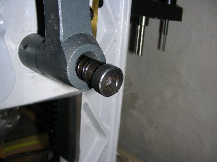

          Ken, what do you mean when you say the handle kept slipping?
            The handle has slots where it connects to the shaft that lowers the cutting head. These slots are so you can readjust the leverage and put more force on the bit if you need to. There isn't a mechanism to keep the handle tight against the shaft (a tendency of all the mortisers from the reviews I've seen). Its not so much a problem as long as you expect it. You can see them in the two pictures in the tutorial showing the set up and clamps. The Jet and others had the same characteristic if I remember the reviews right.

              I have the same machine and have never had mine slip. I'm going to go take a look at it right now to see if there is something different.
                  Ken, I recently got the Delta mortiser as well, and while I haven't uesd it on a project yet, the handle on mine didn't slip at all while I was making test cuts.
                  I know exactly what you're talking about in how the handle indexes against the shaft. On mine, there's a spring that does a very good job keeping the two pieces from coming apart by accident.
                  I almost missed the part about installing the spring when I first put it together. I hope you don't mind my asking - did you install the spring on the bolt that locks the handle and shaft together? If not, maybe the part was missing from your box.
                  -Joe
                      Joe/Jeff -
                      Going to check mine out, maybe I missed something!
                      Well DOHH! Helps if you put in all the parts! Will have to change the tutorial tomorrow. Am glad it wasn't something important like the chisel or bit.

                        It should be installed on the shoulder bolt like this:
