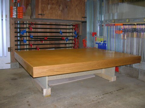

        As it happens, I'm building an extension wing myself, and plan to finish it the same as my torsion box assembly table, which uses red oak trim around all four sides:
        The finish is one coat of General Finishes "Seal-A-Cell" followed by three coats of GF "Arm-R-Seal." If you watch WoodWorks on DIY Network, this is the so-called "tung oil" finish that David J Marks uses on almost everything ... it's actually a combination of linseed oil, tung oil, and polyurethane.
        You can apply it with a soft rag, a foam brush, or a foam roller (I used the latter on my asssembly table).
        Be SURE to heed the label directions about proper disposal of the rags!
            [ATTACH]1078[/ATTACH]
            ... followed by three coats of GF "Arm-R-Seal." If you watch WoodWorks on DIY Network, this is the so-called "tung oil" finish that David J Marks uses on almost everything ... it's actually a combination of linseed oil, tung oil, and polyurethane.
            Ok, two things:
            • Larry, I've read you're complaints of small spaces in your shop, low overhead, etc. Now I look at your assembly area with a fresh view, and I feel obligated to say "YOU SUCK!!!" You know I mean it in the kindest way, brother.
            • Where'd you get that tidbit that Arm-R-Seal is DM's tung oil of choice? It's a good one, and worth remembering, if true.

              Regarding those two things, JR ...
              1. What is not apparent in this picture is that the assembly table measures only 42" x 60", with its top only 18" above the floor; and that I was squatting under the accessory table of my BT when I took the picture ... using the widest angle setting for the lens.
              2. Marks usually calls his finish "tung oil." On a few episodes, he says it's "a blend of tung oil, linseed oil, and polyurethane" (or words to that effect). On at least one episode, he says it's a commercial blend of those three ingredients. A little digging on his web site turned up the following:
              "I have tried various methods of mixing linseed oil and tung oil in the past, but since the mid 80's I've been using a product called Seal-A-Cell and Arm-R-Seal made by the General Finishes Company and available through mail order as well as from Woodcraft.
              "Since doing the first six seasons of Woodworks, this finish has been improved and no longer has the make-up stated in the show. I use two products starting with a sealer and finishing with a top coat. Company representatives state the sealer (which is clear but also available in different colored stains) is a blend of modified linseed oil, oil modified urethane, and alkyd resin, and dryers. The topcoat I use is called Arm-R-Seal and is now an oil modified urethane with dryers. The Arm-R-Seal is available in gloss, semi gloss, and satin."
              So while he says the formulation changed, at least at the time the above was written he was continuing to use it. I figure anything good enough for DJM is good enough for me (although, to give credit where credit is due, it was forum member Otter who first turned me onto these products).
                Yeah RIGHT!!
                Nooooo! I ain't believing a word of that half donkey explanation of the ass-embly table. It's at least 12' by 12', and like JR said, YOU SUCK!!
                No matter how huge it is, it's dang nice, Larry.
