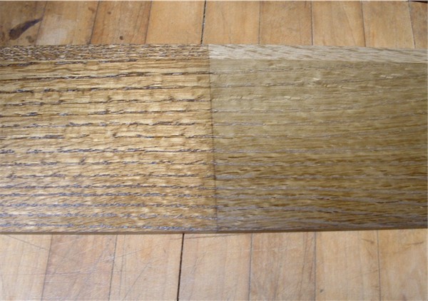

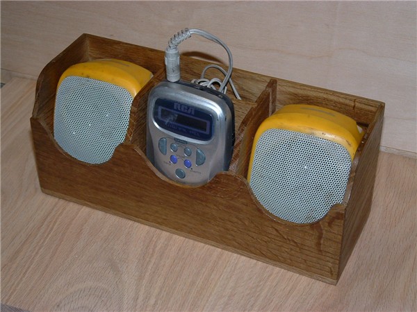

        Ammonia!
        Set it in a sealed (as near as possible) tent with 29% industrial ammonia.
        Right side is fumed, left is stained.
