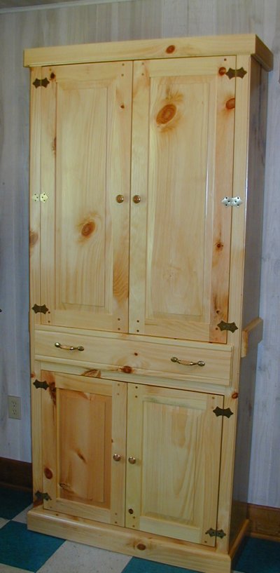

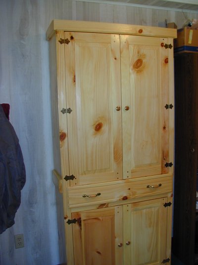

        I wiped on Shellac on this White Pine cupboard

          Ken: great looking cabinet, but I'm looking for something darker.

            Originally posted by Jes Pidlin
            Thanks for the comebacks.
            Think amber shellac. Yum Yum!
            P.S. I hate stain
              P.S. I hate stain
              Yep Jim, amber would do nicely.
              Stain is the work of the devil! Sam, we need a spitting smilie!
