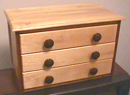

          Here is a photo of a small chest of drawers made from hard maple that I finished with a gloss poly.
          [ATTACH]chest8.jpg[/ATTACH]
          [img]chest8.jpg[/img]
