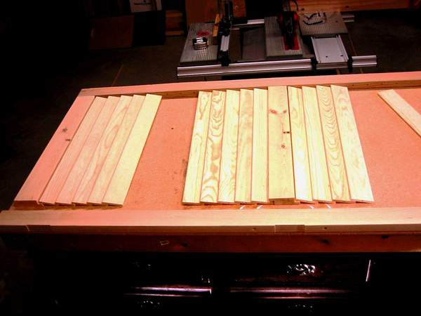

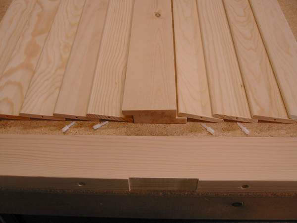

                      I special ordered 3/8" x 4" x 36" basswood "craft boards" from Lowes for the slats. That turned out to be a lifesaver since at the time I didn't have a bandsaw to resaw my own. Even with the bandsaw, resawing all those slats for four doors would have taken forever. If you decide to go this route, I'd order about 20% extra since several of the boards were warped when the order came in.
                      The slats still needed to be ripped to 3" width, cut to length, drilled for the shutter pins, edges rounded over, and sanded. With all those slats, this is still a time consuming project.

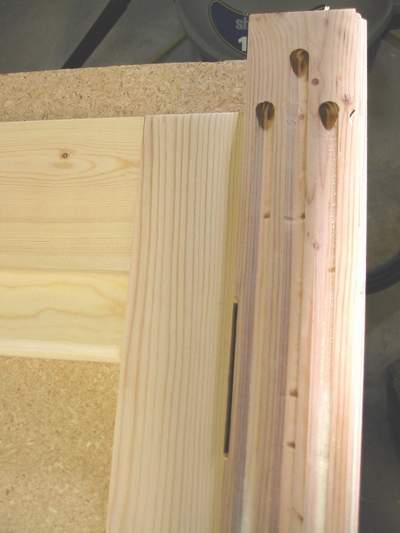

                      As you can see in the pictures, I used shutter pins rather than routing grooves in the stiles. I wanted to have adjustable shutters so we could open them for sunlight and close them for privacy. I think this approach is also a bit easier than perfectly laying out and routing all the grooves for "fixed" shutters.
                      I never got around to taking pictures of the second set of shutters but I'll try to do that this weekend. The second set turned out much better since I had a small jointer and planer to use when making the doug fir rails and stiles.

                            I've attached the pictures from the origninal post. At least I think I did...
                            The finished pictures are of the first set of shutters I built for my dining room.
                            The Assembly photos are from the 2nd set which went in my office.
