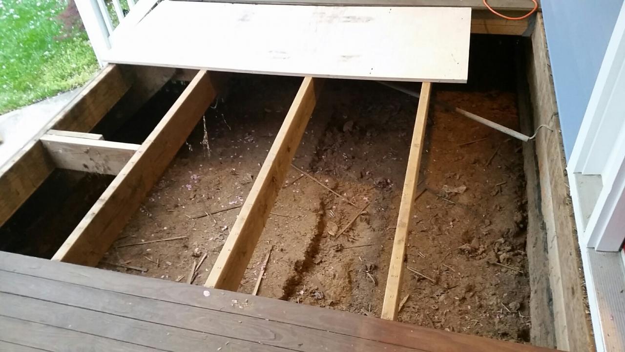

        I ripped off the old flooring this evening--came up pretty easy. The boards were stapled down with 15 1/2 gauge staples. I had bought some trim screws but as I pulled up the boards, I decided that for me or the next guy, I'm going to use staples, too. I have a flooring nailer/stapler. But, oh man, the price of SS staples is crazy! OTOH, I will save a ton of time over screws and screws cost the same per screw, but I don't need a 1000 pack of staples--I need about 150.
        I'm convinced all the spiders in Maryland have or are living under my porch.
        I just laid out the boards to see how everything fit. That last board slid right in with hand pressure.
        As I was pulling up the boards, my wife asked "Are you going to replace these boards (in a different area), too?" Ugh. The challenge is the porch posts sit on the floor, the flooring doesn't go around it. I think I'd have to provide some temporary support to lift the posts up to replace the flooring. Not this guy, but I would love to.
        Edit: Ugh. Noone local sells stainless steel flooring staples. Got to wait to finish this on Monday when Amazon delivers. I'd better find something else to do before the wife adds to my list.
