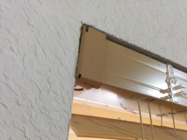

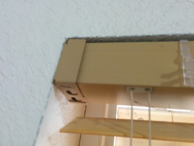

    My blinds seem to be a single mold, no hinges or moving parts. How were they installed, and how do I remove them?
    Tried a bunch of stuff in vain - the tiny lip you see underneath, it doesn't yield to a screwdriver, and it does seem amenable to rotate.

    The fron panel pop up and open us a sme crew driver to pry on the bottom tam and it should come open then slide the blind out.
      • 8807
      It looks to me like the bottom "keeper" or tab that has holes in it - Maybe that tab can be forced to slide toward the center and removed. Usually this sliding keeper tab is on the front. Once the tab is removed, IF it does, then the blind box should be able to wiggle out the bottom.
      Usually, the removable tab is on the front. Could it be on the back? If so, IS there enough room to place the blinds in from the back side of the holder?

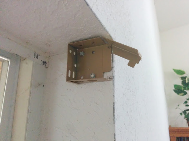

        Thanks, Tom and Hank! You made me go back and relook at the fixings - after all, it had to be right there!
        And truly, the front panel on both ends pops up! (I was trying to make it pop out on the sides).
        Now, on to the real task: one of the cords that pulls the blinds up is broken, so I gotta replace it.
