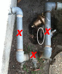

              Ok heres a picture.
              We are removing everything with the red X, one was a feed for the pool, the other for the original irrigation. Both are unused and capped but still get water pressure. When I remove them, I am going to bypass the existing feed for the irrigation (circled in white) so that it will be affected by the pressure reduction. I'm thinking I'm going to need to do something like this:
              _
              |_|
              To line them up.

                The two 90 degree elbows another poster suggested is likely how a pro plumber would do it.
                It appears you intend to connect galvanized pipe to copper pipe, and that will cause corrosion at the joint - the dissimilar materials make a battery and that causes the metal to corrode. You could use a dielectric union to avoid this issue - or just use PVC pipe to connect the two, since PVC is an insulator.
