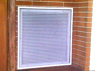

    The return air register for our A/C is a 2' x 2', and is about 4" from the floor. We have two German Shepherds, and three cats. A clean pleated filter has to be changed weekly, if not sooner. It fills up with pet hair in a day or two.
    The picture on the left is the register, and on the right, a clean filter:

    So, I went to HD and picked up a DIY screen kit, and made a frame to cover the register. I used mirror mounting clips at the bottom that the frame just slides in. For the top, I used a cabinet door magnet. Now, all I have to do is remove the screen and brush it off. Here is the screen after one day:

    Good idea, looks to work well

        Good idea, but I would be concerned on how the screen would impact the return airflow though.

              That is a great solution, very good thinking! A very cheap pre filter that seems to work well. kudos
