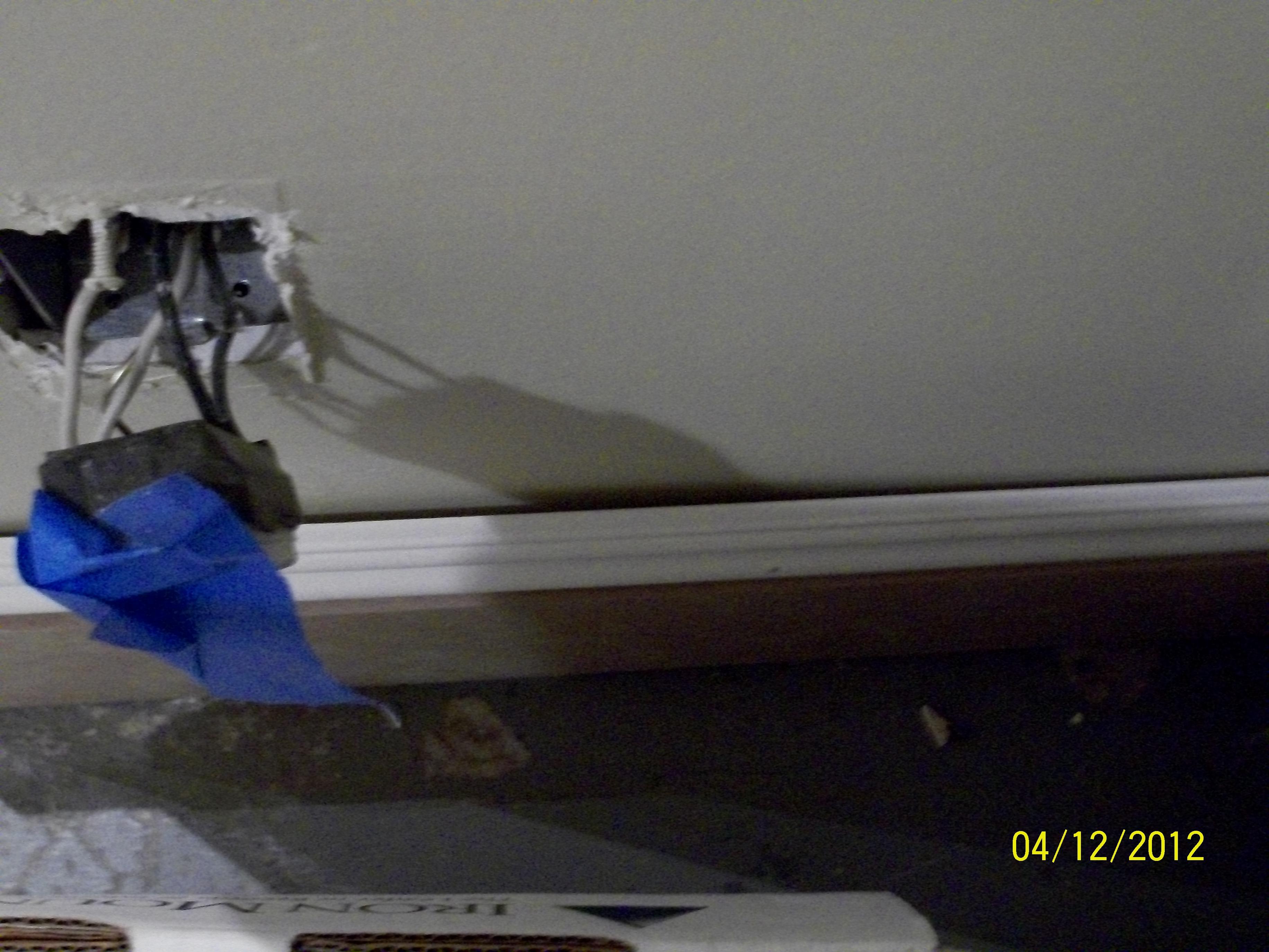

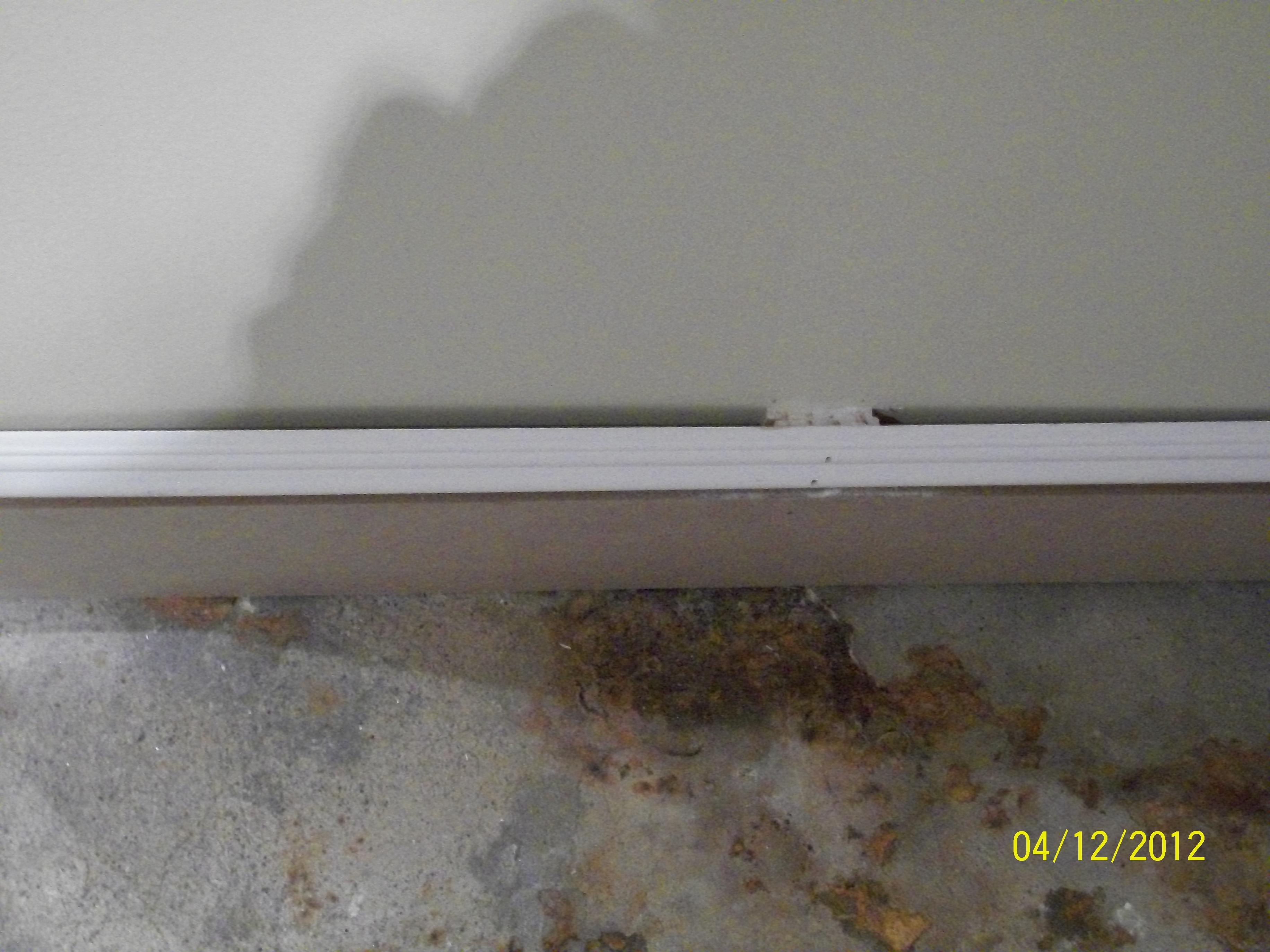

    with almost all of the basement trim done, I'm now looking forward to caulking nail holes and trim gaps. but a few of the base cap lengths have gaps of between 1/4 and 5/16" in the middle of some short runs, which, of course, fade to no gap at the inside and outside corners. this is compliments of the taper who taped the room. what has anyone used successfully to fill such large gaps? i realize i could just keep pumping caulk into the gap, but that seems to be both wasteful and really amateurish. backer rod comes to mind, if i can find it up here. any other ideas?

        Looks like whatever framing that was attached to the walls wasn't shimmed out properly in that spot. Shimming is typically necessary because basement walls aren't always flat.
        I'd be inclined to remove the base and drywall, shim the framing flat, then install new drywall and put the base back. Depending on how the framing is attached to the walls and floor, you will probably find yourself shimming between the framing and drywall, instead of between the framing and the wall.
        Caulk could work. Make sure it is LATEX caulk. Modern acrylic paints will stick to latex caulk fine. The DAP latex tub/tile caulk is great for paint adhesion.
        But I think in the long run, the shimming would look nicer.
          At this point I think caulk is your best option. I prefer to put a trim head screw into the middle of a run like that and suck it down to 1/8 or less. Or I sand off some joint compound where the trim will go (actually you could do this if you are willing to take the trim off). I'm not sure you can use a screw to suck it closer to the wall, however, because it will mess up your miters. If you coped it at the ends, that may still be a possibility. If you have nothing else to screw to you can screw into the baseplate of the wall.
          I like white lightening caulk. It is cheap and it shrinks a lot but it goes on quickly and takes paint well. For a large gap, two applications (at least) are likely to be necessary. Backer rod will save you some caulk but I don't see anything else it will do for you. Maybe make the caulk more flexible (because the middle is thinner) but I rarely use it. If you don't have gaps at the time you paint my experience is you will not until at least next winter when the indoor humidity is very low. In my experience nothing stops some gaps from forming then.
