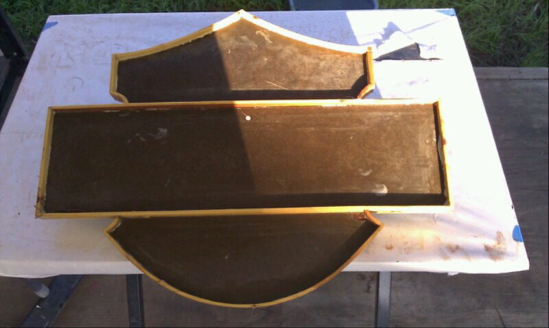

    I had a concrete pad for the kickstand to set on with a Harley emblem cut into it. I decided to make a stamp to add the emblem to the ramp.
Name:	Emblem Template.jpg

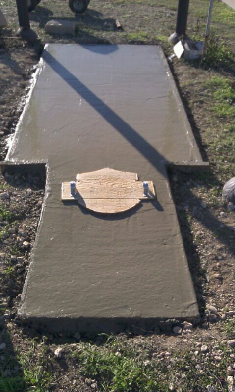

    Stamp set into place, hoping it would work...

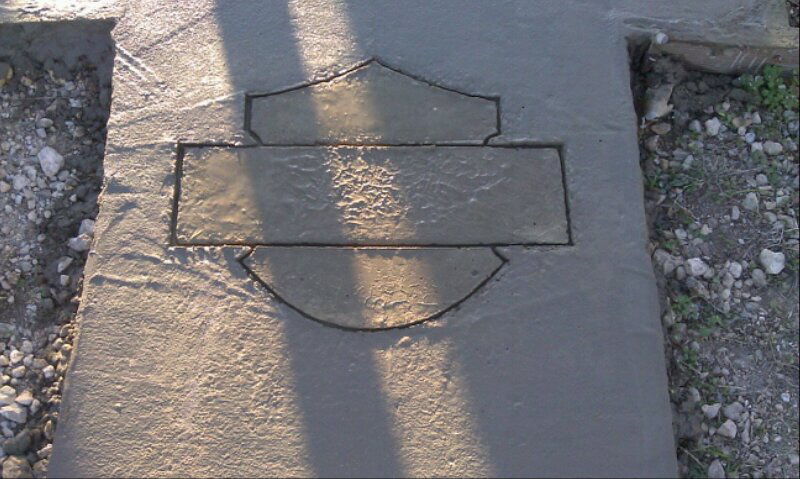

    I may need to do some clean up work with a grinder disc but I am happy with the result!
Name:	Ramp Emblem.jpg
